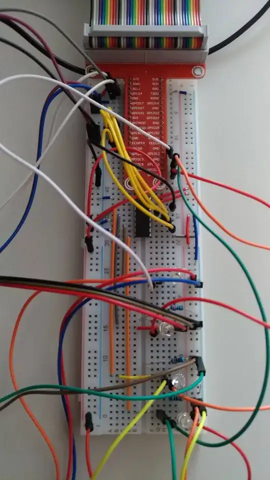

I'm doing a project for a school assignment and have some issue with my circuit. When I connected the breadboard to pi and to power, everything was working, I could read data from sensors and looked fine. However, after 30-50minutes my pi stopped working and a green LED is dead. I believe I have burnt my new pi. I just want to know what happened, what I'm doing wrong before I'll try to run this on a new pi. First of all, I would like to ask if there's a limit to wired sensors/devices because I'm using a few. Maybe it was an issue?
Let me describe my circuit:
  • Serial LCD wired to SDA, SCL
  • DHT11 temp&hum wired to GPIO4
  • MCP3008 wired to MOSI, MISO, SCLK, GPIO5. I'm using only 1,3,5,7 channels. unused are wired to GND to reduce the noise. Used channels go down on the breadboard and are connected to soil moisture sensors (please see attached picture).
  • 4 soil moisture sensors connected to analog inputs in MCP
  • 4 diodes (red, green, blue, white), 4 resistors 220 R, each diode connected to GPIO to manage them from phone app I'm wiring 3V3 output to + in the breadboard and every sensor/device is wired to this power. I'm wiring 2x GND outputs to - (left and right side of the breadboard).
Please see attached pictures: circuit with mcp, dht11, lcd, leds enter image description here
pisar
There is no practical limit to the number of digital and analog connections you can make. There are some logical limits, such as having enough chip selects for SPI, enough addresses for I2C and enough pins for GPIO, but this is not a problem here.
There is, however, a limit to the power you can draw from the supply voltage rails. Both the 3.3V and 5V rails have current draw limits. If you exceed the limit a few things might happen - fuses might blow or voltages might collapse. Neither of those scenarios are particularly destructive. One destructive scenario is that the voltage might become marginal - it's possible that a marginal or fluctuating supply voltage could cause damage, either to the microprocessor itself or to the SD card, both of which are susceptible to poor voltage regulation.
Given that you're running everything off the 3.3V rail, and this rail is not particularly beefy, that would be the first place to look - calculate your total current draw and compare to the rail's capability.
But all these scenarios are probably just as likely as a freak occurrence. Given that your setup worked for so long before failing, it's possible the number of devices is not related - perhaps there was a momentary short, a supply surge or any of many freak incidents.
Unfortunately it's very hard to determine the root cause from the information you have given, but here's a good plan of attack:
  1. Do the power consumption calcs.
  2. Check how the LED failed - is it short or open? If it's short, maybe it was the root cause, bringing the Pi down with it.
  3. Check the Pi without any peripherals attached. Does it boot, and if not, what seems to be the problem.
  4. Using all these results, try to narrow down the root cause.

  • @pisar Yes, anything Vcc = 5V might kill Rpi. DHT11 Datasheet https://www.oddwires.com/content/DHT11.pdf – tlfong01 Apr 26 '19 at 13:48
  • "I believe I should see the specification of a sensor and sum consumptions.". That's it! "But I cannot find some specs" well then you're stuck - you'll just have to cross your fingers. No, the LCD requiring 5V is only a problem for the LCD, not the Pi. @pisar's well meaning post has it all backwards. If you connect 5V to the LCD, you will definitely damage the Pi without proper level shifting. It's more and more likely that you're overloading the 3.3V rail. Use 3.3V devices, or 5V devices with a level shifter. – Heath Raftery Apr 26 '19 at 21:49

The root cause might be you are using 3V3 Rpi to talk to 5V0 guys.
I read your question and found nothing wrong. I also use the devices like yours, perhaps twice more.
But there is a catch - I never direct connect Rpi 3V3 GPIO signals to outside things. I almost always use a logical level shifter, converting Rpi's 3V3 signals to 5V and interface with outside things.
For example, I play with I2C LCD shown below.
I know these LCD are almost always Arduino compatible (I played with them in my Arduino days) - In other words Vcc = 5V. That means it is NOT Rpi compatible. The chip PCF8574 is very likely Vcc = 5V. I am pretty sure, because I never apply Vcc = 3V3 for the LCD and all the other I2C SPI guys.
I am not suggesting you to use logical level converter, like me. But if you direct connect Rpi 3V3 GPIO to 5V devices, it might work for some time, but sooner or later it will burn.
You might also like to read the following post about another unlucky guy burning his new Pi.
DHT11 sensor and the wrong voltage may have fried my RPi3
To summarize, if you connect Rpi GPIO even through a resistor to 5V, then Rpi might have its life shortened, if not burnt immediately. The picture show why DHT11 with Vcc = 5V might be a problem. See my answer in the above post for more details.

  • I followed my friend's instruction who told me "Never use 5V in PI" even though tutorial about i2c lcd said 5V. I just thought that 3V3 will be safer. What I'm gonna do is connect lcd to 5V. The question is should I connect DHT to 5V as well? In datasheet is 3.5~5.5V DC so 5V seems proper. Am I right? Can I connect lcd directly to 5V RPI output or should I use logic converter? – pisar Apr 26 '19 at 14:18
  • Yes, your friend is right, never use 5V in pi. The LCD tutorial are usually from Arduino days when everybody is using 5V. About logic level converter I always listen to this guy - ​"An ounce of prevention is better than a pound of Cure": Benjamin Franklin. – tlfong01 Apr 26 '19 at 14:32
