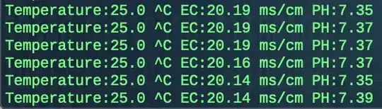

Screenshot of output
You can adapt to your project and works properly.

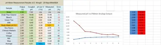

Now I have enough samples, from very acidic to very basic, to get the ph per volt ratio which is used to get from measure analog output in volts to the pH value.
I am making morning coffee with milk, and a selfie!
coffee with milk
I updated the Excel worksheet with coffee and tea. Now the average pH/V is recursively self calibrating, meaning that more measurements added, more "accurate" is the average pH/V.
What I found too good to be true is that the measured pH value of the JJ body wash claiming pH5.5 is 5.51!
ph table

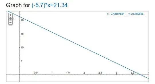

Now I have drawn the graph to get the values for the Rpi python program to calculate the pH values.
ph worksheet

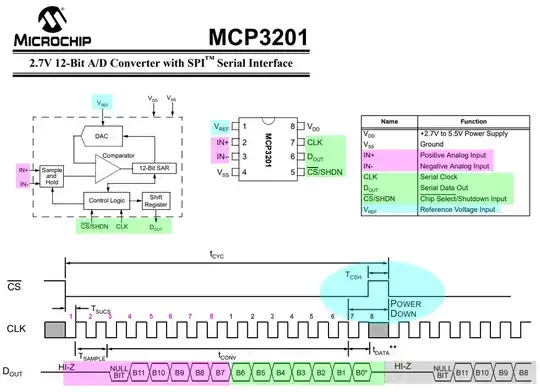

So I am thinking of using another ADC. I am considering MCP3008 and MCP3201. SPI MCP3201 seems appropriate for this pH meter project, which needs only one channel, thus the Rpi python SPI program should be easy to write and debug.
MCP3201 SPI 8-bit ADC to convert the pH meter analog signal
Comparing MCP3201 with PCF8591 Record
MCP3201 12-bit SPI 2.7V - 5.5V 100ksps max
PCF8591 Datasheet - NXP
AliExpress PCF8591 AD/DA Converter Module Analog To Digital Conversion temperature illumination For Arduino - US$1.37
lipton tea
Programming MCP3201 to convert pH meter output
MCP3201 seems even easier than MCP3008, because it has only one differential channel, no need to mess around with which channel single ended, which channel differential, and should idle channel pull up to reduce noise etc.
mcp0321

    Big thanks @tlfong01 only your formula works for me - just a bit edited ;) So when I read data via command: gpio -x pcf8591:120:0x48 aread 120 .Then I calculate phValue: 7 + ((parseFloat(data) * 3.3 / 255) - 2.5) * (-5.7) – Marek Javůrek Mar 24 '20 at 21:53
  • @Marek Javůrek, I am glad you solved your problem. Your formula is scarcely long, I need to have a cup of coffee before I try to understand it. Cheers. – tlfong01 Mar 25 '20 at 02:00

In addition we have to calculate the voltage conversion that will give us the pH sensor so we will need two pH reference value and measure the voltage returned by the sensor on the pin Po. The best thing to do is to use a calibration solution in powders, there are also in liquid but it is easier to preserve the powders. These solutions are sold in different values but the most common are pH 4.01, pH 6.86 and pH 9.18.
Graph of the measured voltage and pH equation
Graph of the measured voltage and pH equation. y= -5.70 * x + 21.34
Using the powders with pH 4.01 and pH 6.86 we obtain the voltages on the pin Po 3.04V and 2.54V respectively. The sensor is linear so by taking two points we can deduce the equation to convert the measured voltage to pH. The general formula would be y = mx + b, so we have to calculate m and b since x would be the voltage and y the pH. The result is y = -5.70x + 21.34.
