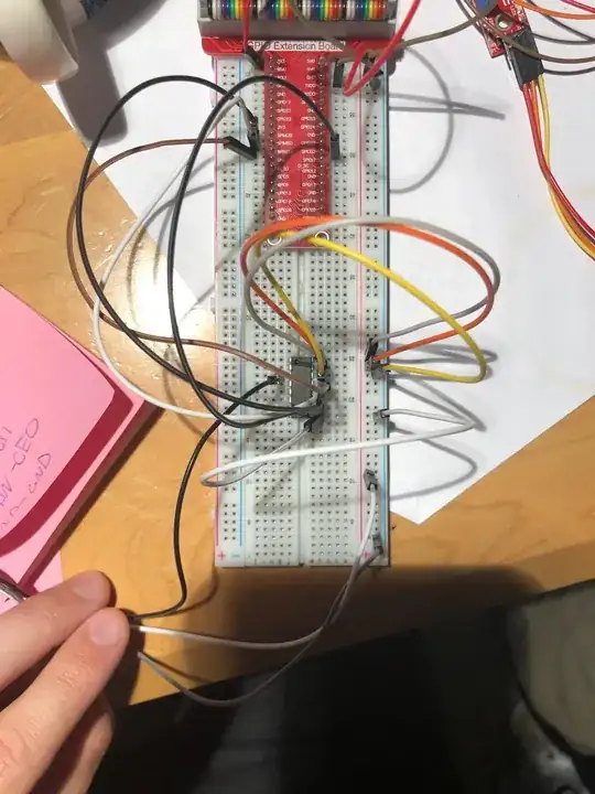

Below are photos of my setup and the results. NOTE: In the results photo, I plugged the photoresistor in channel 3, which is why the 3rd column is all 1023, the max value.
Set up (without sensor)
Results when plugged into Channel 3
  • It is difficult to make any sense from a photo of untidy wiring. One thing you should definitely do is connect all unused inputs to ground. – Milliways Sep 12 '19 at 22:33

You've got one channel connected and the rest of the pins floating. Those pins that are floating are, well, floating, and there's not reason to think they should have any value in particular nor that whatever value they have will remain constant. That's not "noise" in any usual sense of the word because noise is usually with reference to a signal and those unconnected pins have no signal associated with them.
The pin that is connect to your sensor doesn't demonstrate any characteristics of noise either, at least in the fully lit room. It is, as far as I can follow your description, showing a maxed out (constant) value in the lit room and a constant value in the darkened room. If it were noise, the values would be changing around a signal level. It's not clear from your description if that's happening or not as the text around where you say "500 or 600 (+/- 100)" doesn't clearly indicate if that's a time-series fluctuation in a reading or the result of several different attempts.
If you did see noise on the channel that's connected, however, there's nothing here to suggest that's the ADC rather than noise at the sensor or actual, detectable variations in the lighting.
So based on the information that you've given so far, there's no clear indication that you're seeing anything unusual.

  • So a floating pin is a pin which is not connected? Should I ground them? Why then does the connected sensor pin fluctuate so wildly?
    Also after grounding the other pins, now the readings on the sensor pin are much more understandable. Readings of around 1000 in bright light, and down to 100 - 0 when in low light. Is the variation in values under a constant light (either bright or dark) natural?
    – Tuomas Talvitie Sep 13 '19 at 15:31
  • Pin not connected externally are not being pulled to any particular value. They have some connection internal to the chip that may or may not cause the values there to vary. For example, if the pin isn't connected, there's no a priori reason to think that reading from the pin won't change the value since some (very small) amount of current must flow to read it. I haven't used MPC3008 for a while, but I don't recall any reason that the values of one channel would impact the values on another, pins grounded or not. Check the spec sheet though. – Brick Sep 13 '19 at 15:34
