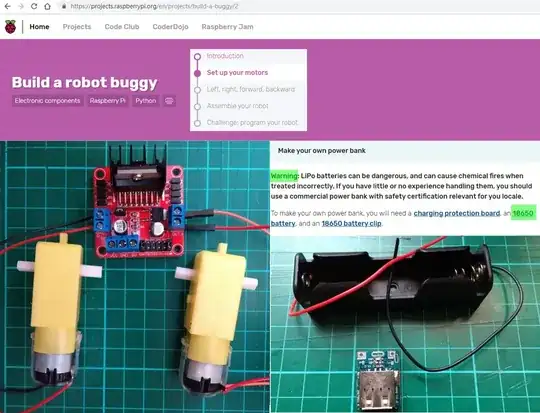

I know I asked this question before, but this time I will give a more clearer description. I have been using the raspberry pi for approximately 6 months now. I am making a very simple robot car that includes a motor and ultrasonic sensor circuit. The ultrasonic sensor works perfectly but the motors aren't spinning with my circuit and programs. Please help:
Info and details:
I am using a 9v battery, and l298n, 2 DC Motors and the raspberry pi and some wires for the motor circuit. You can see the circuit in the picture below made using the app fritzing:
Then I programmed the circuit using the raspberry pi using python and the RPi.GPIO library / module. The code is below:
