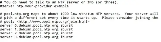

Time server settings are saved in /etc/ntp.conf so open your favorite editor and make this change.
sudo nano /etc/ntp.conf
The relevant section looks like this:

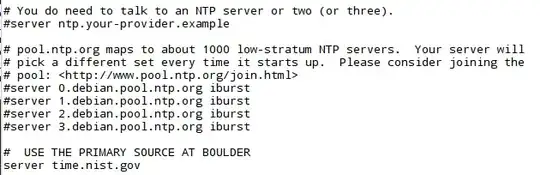

So all you need to do is change it to look like this on all the relevant computers:
then reboot them.
Voila, the systems are now all using the NIST/NBS Master Clock to synchronize.
