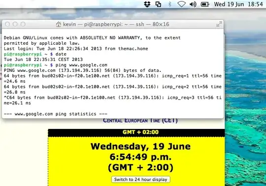

The thing is - it seems to be an entire day out and I think that it is configured to the correct time zone. See the following screenshot:
Time Zone
Notice the date in the top right hand corner and compare it with the date in the terminal and with the browser behind showing the date and time. Notice also that I pinged google and it came back fine so it has an internet connection.

I tried restarting the ntpd:
/etc/init.d/ntp restart
And checking the peers:
$ ntpq -p
     remote           refid      st t when poll reach   delay   offset  jitter
 94.136.21.140   73.121.249.250   2 u   27   64    1  1432.35   -7.155 140.072
 ns4.nosuchhost. 131.130.251.107  2 u   30   64    1  1700.38  118.357  18.616
 ntp1.sil.at     183.183.106.246  3 u   37   64    0    0.000    0.000   0.001
 fetchmail.media 83.64.124.251    2 u  20h   64    0    0.000    0.000   0.001
running ntptime gives:
ntp_gettime() returns code 5 (ERROR)
  time d56c8b65.3a5f0000  Wed, Jun 19 2013 21:56:21.228, (.228012),
  maximum error 16000000 us, estimated error 16000000 us, TAI offset 0
ntp_adjtime() returns code 5 (ERROR)
  modes 0x0 (),
  offset 0.000 us, frequency -28.937 ppm, interval 1 s,
  status 0x4041 (PLL,UNSYNC,MODE),
  time constant 7, precision 1.000 us, tolerance 500 ppm,
Still the time is wrong and I see an ERROR! But how do I solve that?

ping to google looks just fine, but what results you get from ntptime ?
$ ntptime
ntp_gettime() returns code 0 (OK)
  time d56c8aa0.a60e5194  Thu, Jun 20 2013  4:53:04.648, (.648656024),
  maximum error 817308 us, estimated error 952 us, TAI offset 0
also, for changing your time zone, the recommended way is running sudo raspi-config, then using 4 Internationalisation Options and I2 Change Timezone to do the trick instead of manually editing config files.

Restart the NTP daemon
All my configs, timezone, internet connection were ok, the daemon was also running but the time was wrong. So this is how I fixed it.
sudo /etc/init.d/ntp restart
Voila! correct time.
