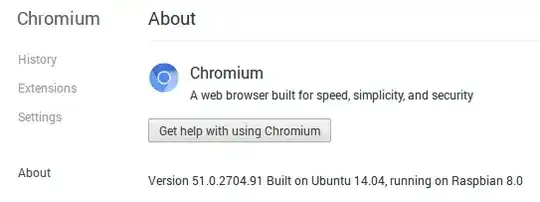

In Chrome://settings, select About and verify the version:
Enter image description here

Although Chrome has automatic updating on Windows and macOS, Chromium does not auto-update on Raspbian nor any flavor of Linux. To force an update of Chromium, run:
sudo apt update
sudo apt install chromium-browser
It's hard to pinpoint exactly why logins were working fine on one system but not others, but running an old version of Chromium (April 2016 as turned out to be the case above) could naturally cause problems!
