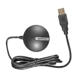

GPS Receiver
I would go for a generic usb GPS receiver such as the BU-353
BU-353
It works with the Raspberry Pi, just like a normal linux computer.
Most usb GPS receivers are just USB-to-Serial adapters that read the NMEA data from the GPS receiver. Look into pl2303 (many units i've seen use this particular chip) drivers, should be available.
You can also use GPIO and a traditional NMEA 0183 GPS receiver, but then you need to worry about power, and the prices are often higher. GPS antannas are common onboard boats and ships, and usually consume 12v.
The usb solution is cheaper.

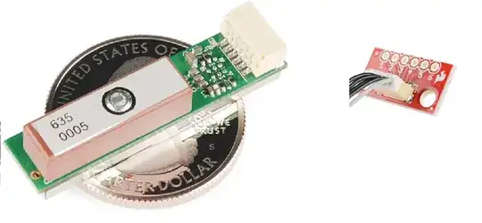

If you do not want to use USB you can use TTL GPS recievers. Sparkfun does a very fast 50 channel GPS receiver but you can find other ones on eBay or other sites.
You can use this by disabling the serial console on the Pi and connect the receiver directly to the UART pins.
* Remember to check the voltages of the GPS device you are using
