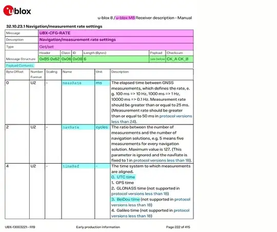

            unsigned char packet[] = { 0xB5,  0x62,
    0x06, //
    0x08, //
    0x06, // length
    0x00, //
    0x64, // measRate, hex 64 = dec 100 ms
    0x00, //
    0x01, // navRate, always =1
    0x00, //
    0x01, // timeRef, stick to GPS time (=1)
    0x00, //
    0x7A, // CK_A
    0x12, // CK_B

  • @awaska, Part A of my answer shows how to use the u-center to set my Neo-8M measurement rate to 0.25Hz, and the measurements now repeat every four seconds. You might like to verify with your Neo-6M. Good luck. Cheers. – tlfong01 Jun 20 '20 at 13:09

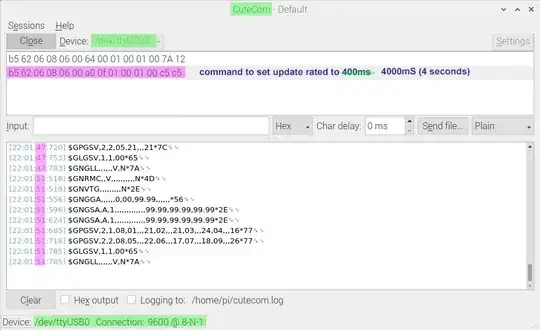

  • Part B shows how to use CuteCom to send 14 byte UBX command to change the update rate to 4 seconds. – tlfong01 Jun 22 '20 at 15:10

Part B - Using cuteCom to send UBX message to change update rate to 4 seconds

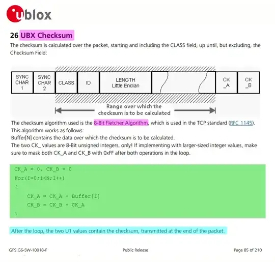

(1) Try end measurement/navigation frequency command with the two check sum bytes. See Appendix E for an example to calculate the check sum for a update rate to 4000mS command.
(2) Try end UBX message with CR, LF. (update - CR, LF is not necessary for hex input, only necessary for text input)
Note - it is much more newbie friendly to use GUI Rpi terminal emulator cuteCom than CLI bash echo and cat.
I have compiled a command message to set the measurement rate to 4 seconds. Then I used cuteCom to input the 14 byte command string to Neo-8M serial. Neo-8M accepted the command and measurement rate became 4 seconds.

Appendix B - UBX Checksum
ubx checksum

Appendix D - UBX Checksum Program
checksum 1
Appendix E - Python program to calculate checksum
# fletcher_chksum02.py Fletcher 8-bit checksum - tlfong01  2020jun22hkt2147

synC1 synC2 class id length measRate navRate timeRef checkSum measurement update rate
0xb5, 0x62, 0x06, 0x08, 0x06, 0x00, 0x64, 0x00, 0x01, 0x00, 0x01, 0x00, 0x7A, 0x12 measRate 0x64 = 100ms = 0.1 sec
0xB5, 0x62, 0x06, 0x08, 0x06, 0x00, 0xC8, 0x00, 0x01, 0x00, 0x01, 0x00, 0xDE, 0x6A measRate 0xc8 = 212ms = 0.2 sec
0xB5, 0x62, 0x06, 0x08, 0x06, 0x00, 0xa0, 0x0f, 0x01, 0x00, 0x01, 0x00, 0xC5, 0xC5 measRate 0xfa0 = 4000ms = 4.0 sec
dataByteList01 = [0x06, 0x08, 0x06, 0x00, 0x64, 0x00, 0x01, 0x00, 0x01, 0x00] dataByteList02 = [0x06, 0x08, 0x06, 0x00, 0xC8, 0x00, 0x01, 0x00, 0x01, 0x00] dataByteList03 = [0x06, 0x08, 0x06, 0x00, 0xa0, 0x0f, 0x01, 0x00, 0x01, 0x00] # measRate = 0xa0 0x0f = 0xfa0 = d4000
def calcCheckSum(dataByteList): ckA = 0 ckB = 0 for dataByte in dataByteList: ckA = ckA + dataByte ckB = ckB + ckA ckA = ckA & 0xff ckB = ckB & 0xff print(hex(ckA), hex(ckB)) return
calcCheckSum(dataByteList01) calcCheckSum(dataByteList02) calcCheckSum(dataByteList03)

Appendix J - CuteCom Screen Shots Showing Neo8M Config Command Acknowledgement Messages
ack msgs
Appendix K - Neo-7M Changing Update Rate to 4 seconds, Enable RMC and ZDA Only
neo-7m change update rate test
