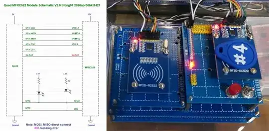

Part A - RFID Reader Triangulation
rfid reader
See Refs 1, 2
/ to continue, ...
