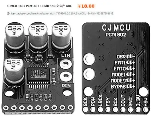

We are given a CJMCU PCM1082 ADC Module and a MAX4466 microphone.
CJMCU PCM1082 ADC Module has SCK,PDW,LRCK,FSY,BCK,DOUT,GND,3.3V,5V pins also with LIN and RIN.
Connecting the 3.3,5 and GND are pretty obvious, but for the other ones, I read the PCM1802 IC datasheet that is used in the module, And I found out that:
  • SCK is System clock input
  • PDW is Power-down control which is active low.
  • LRCK is Sampling clock input and output
  • FSY is Frame synchronous clock input and output
  • BCK is Bit clock input and output
And DOUT is simply serial output.

Drawing the schematic for Rpi GPIO interfacing CJMCU PCM1802
cjmcu pcm1802

Appendix C - PCM1802 Module Features
pcm1802 module features
