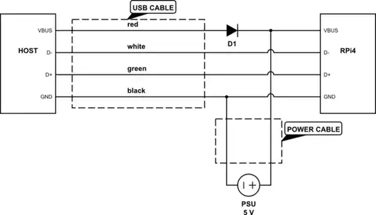

Is it possible to make such an Y splitter cable? If so, how to make it? Or is there a better alternative? A simple drawing would be nice.

The problem here is that the RPi 4 USB-C connector is hard-wired as an upstream-facing port, which urges the host device on the other side to provide power. Yet if you power the RPi from an independent power supply (using an Y-cable or via the 5V pin), this supply will be connected in parallel to the host device's 5V output, which is problematic.
The simplest solution would be to make a cable which only conveys USB data signals (and ground) but not 5V. However, such a cable wouldn't behave in strict compliance with USB if plugged into an unpowered RPi, because signals on D+/D- lines may then have higher voltage levels that VBUS. Personally I'd add a diode feeding some voltage from host to the RPi (which, as you said, won't likely be enough to power the RPi anyway), just to cover this case. Here's how an Y-cable could look like:
schematic
You still shouldn't plug the cable in the RPi while the PSU is off, because that would result in the overcurrent on the host USB port, but at least that won't damage the RPi. If you're careful about always plugging the PSU first, you could omit the diode (leaving VBUS line disconnected).
The power cable could also be connected to 5V/GND pins on the GPIO connector, which will correspond to the same circuit when the USB-C connector is plugged in.

  • If you add a diode to the connection between the PSU and the red wire, you will form a "wired OR" connection, and then no worries about back-feeding PSU from HOST or RPi. Also, many diodes (Si) have a 0.7 Volt drop which may be enough to "upset" the RPi. A Schottky diode will reduce this to ~0.3 V. – Seamus Apr 19 '20 at 01:07
  • remove the diode at all, PC supply is not enough to power the pi anyway, just plug the PI power supply BEFORE plugging it to the PC – Phil May 21 '20 at 16:50
  • made this, https://i.imgur.com/XaCSjMM.png it does not work so far... – Phil May 21 '20 at 18:53
  • @fdsfdsfdsfds: Did you ever get this cable to work as advertised? If not, what does "not work" mean exactly - have you taken measurements? – Seamus Mar 13 '21 at 07:00

  • The voltage drop is only significant if there's current through the diode. In my answer, the diode is normally closed, it only opens if you forget to power the Pi properly. – Dmitry Grigoryev Mar 10 '21 at 07:59
    Also, I bet you (and the person who upvoted your answer) didn't actually try this schematic, did you? Schottky diodes on USB data lines will exceed the allowed line capacitance by an order of magnitude. – Dmitry Grigoryev Mar 10 '21 at 09:35
