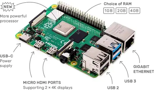

The OTG USB port is the USB Type C port that is also typically used to power the Raspberry Pi 4. I haven't independently verified this for myself, but if your computer provides enough power, or you get a modified cable that lets you provide more power than your computer does directly, you should be able to use the Pi in USB Gadget mode the same way you could in past Raspberry Pi's.
It's the USB-C port in this diagram: Diagram of Raspberry Pi 4, indicating USB C port used for OTG

    USB C cables are reversible (unlike 2.0 or 3.0 cables) and I would like to believe the ports are too, somewhere -- eg., you could take a laptop with multiple C type power inputs and use one as an input and one as an output. Quick search did not confirm this though. – goldilocks Jul 12 '19 at 12:56
  • @goldilocks you definitely can to some extent, but (at least with my laptop, a MacBook Air) it can only provide 5 volt output, not higher voltages like it accepts as input. This is fine for the Raspberry Pi, which only uses 5 volts, but given the controversy there seems to be about the wiring of the USB C port on the current version of the Pi 4, I doubt most laptops will be willing to provide the 2.5-3 amps the Pi requires. – Patronics Jul 12 '19 at 13:00
