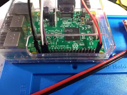

I bought two DROK L298 H-Bridges to control my DC motor (one for backup). I've connected it up to my Raspberry Pi 3 with BCM 12 as my PWM and 16 and 19 as my IN1 and IN2. Below is my code to test if the motor works - but it doesn't turn.
I tested the code on an L293D chip which turns the motor and tested both L298 H-bridges with no success. Looking for thoughts on how to get the motor working on the L298 H-bridge.

  • Update * Pictures of the spec sheet & connections
Connections
Connections2
Spec Sheet
  • Update 2 - Realized GPIO 12 was in the wrong pin. Changed it to the correct one (5th up) but still no motor turning.
  • We need a clear photo showing the connections between the Pi and the motor driver board. – joan Dec 24 '18 at 23:06
