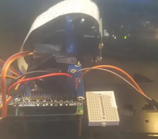

EDIT: Added some pictures Picture of my L298N driver wiring Picture of my RPi connections
The orange and brown wires are the motor driver's power and ground. EDIT 2: More pictures

    Please show a clear photo of the connections you have made. There is no way to do what you suggest provided you have made the correct connections. You have therefore made wrong connections and may be destroying the Pi. – joan May 14 '20 at 15:35
    @joan, I have never put any diodes or connected the motor driver yet. I'm just simply expressing my concern for my Pi, because I've observed that the motor driver can generate around 3-4v when I spin the motors attached. I'm just afraid of the power momentarily powering the Pi and corrupting the file system. – Unsigned_Arduino May 14 '20 at 15:47
