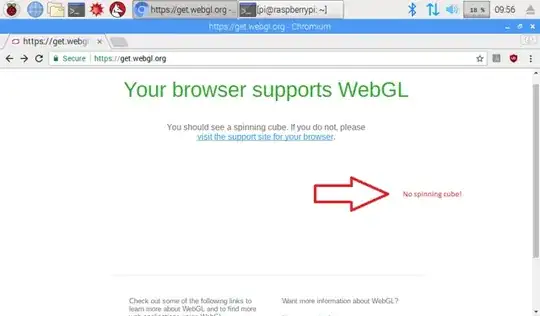

I have a problem with WebGL on Raspberry Pi 3's Chromium browser. I did the settings required but nothing happened.
Here is my information
  • Device : Raspberry Pi 3
  • OS : Linux raspberrypi 4.9.80-v7+ #1098 SMP Fri Mar 9 19:11:42 GMT 2018 armv7l GNU/Linux(Raspian Stretch with desktop, i also try lite)
  • Browser : chromium-browser version => Chromium 60.0.3112.89 Built on Ubuntu 14.04, running on Raspbian 9.3
  • Graphics Driver : vc4-kms-v3d
Here are the get.webgl.org results:
Here is the threejs.org example ("webgl_animation_cloth") results:
threejs.org example "webgl_animation_cloth" results

I tried several settings on chrome://flags but nothing is changed
When I start chromium-browser from the command line, I see
libgl error: MESA-LOADER: failed to retrieve device information
but @eric-anholt say this should not have important effects.

Okay so I found a solution here: https://www.raspberrypi.org/forums/viewtopic.php?t=191087
  1. use raspi-config to enable OpenGL (Full KMS)
  2. remove "--disable-gpu-compositing'' from /etc/chromium-browser/customizations/00-rpi-var
is all you need to do to get the https://get.webgl.org cube spinning.
Works for me!
JoeyCK
  • 718
  • AS you see the firefox screenshots,OpenGL(Full KMS or Fake KMS) is enabled, and i try the flags. I think this is the interesting part, everything seems like legal but, the cube is not shown!! – Mehmet Bayrak May 15 '18 at 11:18
  • @MehmetBayrak did you try editing the file as stated in my answer? I am not using any flags. – JoeyCK May 15 '18 at 13:41
    Yes!, you are right when i edited "/etc/chromium-browser/customizations/00-rpi-var", it works! thanks – Mehmet Bayrak May 22 '18 at 09:56
