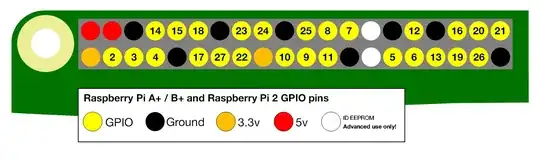

Pins
As stated in the documentation, the pins are GPIO 18 (SDA) and 19 (SCL). This site helps locating them on your RaspberryPi (layout should be the same for RaspberryPi 2, 3, Zero and Zero W)
This schematic from the site will help: RaspberryPi GPIO Schematic
