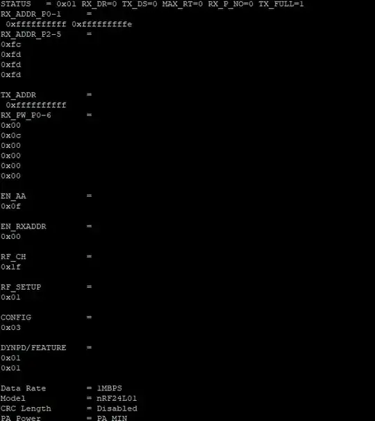

The NRF24 code has a python command 'radio.printDetails', which outputs various parameters related to the NRF24's status. For the still-functional units, the output of this command appears stable. What I mean by this is that things like the radio channel number, transmission pipes or transfer rates match those specified in the code (and do not alter unless changed with the code). However for the non-functional units these parameters seem to be random and often change between two consecutive attempts to run the identical code. Also, the code may specify 1MBPS, but the status command might output 250KBPS (or it might output 1MBPS or some other number).

i also working with nrf24l01 and raspberrypi it works before after update it is not working crc length disable gettingenter image description here
