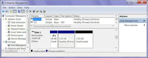

I'm answering this because this was one of the first results on Google and I had the same problem.
Windows has great difficulty reading a SD card after the raspberry Pi installed files on it. My SD Card had 2 partitions, the first one only being 61 MB, the second one was 26 GB. Next to that, there was almost 1 GB unallocated.
Windows can only see the first partition, thus showing the card as 30/61 MB.
However, Windows Disk Management does recognize everything. Check it here:
Computer Management - Disk Management screenshot
This screenshot is from another site, but it shows the problem. In this case, Windows Explorer only shows a 56 MB SD card, while the SD card is 16 GB.
Start > type in "Create and format disk partitions"
Now, I wanted to completely reinstall Rapsbian, so what I did is the following:
  1. Delete the large middle partition
  2. Delete the small partition on the left
  3. Create a new simple partition
For me, the application recognized that there was 29 GB of unallocated space. I was able to make a new 29 GB partition. From there one, I started from scratch in installing Raspbian and Retropie.
