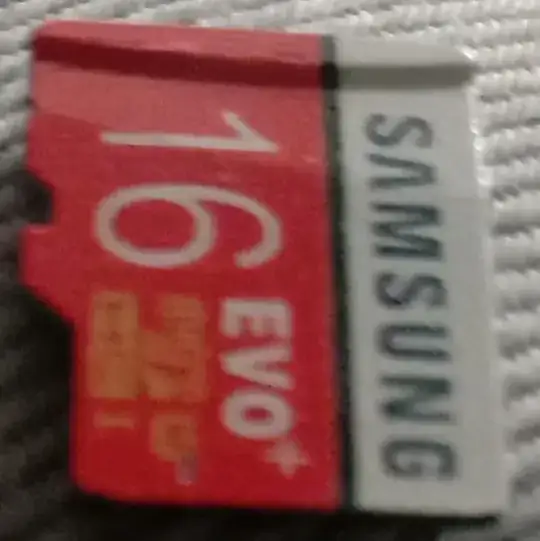

I have same problem with an 16GB SD card of Samsung. After trying all the software solutions available on internet i moved onto hardware issues and figured out there is very small crack on the SD card that can not be observed easily. i observed it with flashlight.
Image of SD Card
Its cause was the SD slot of raspberry pi. I put the PI in my backpack where he received some kind of force on it that resulted in crack. After this crack the SD Card shows on the windows disk Management as 13MB RAW Disk and noting else.
  • Was getting nowhere with a 16GB SanDisk micro SD card, macOS was only seeing 32.1MB (tiny). Just noticed a crack in the label face similar to the one in your image. I suspect I broke it when pulling the RPi out of its case (after failing to get the card out with my finger nails). – Peter Cock Jun 10 '20 at 16:00
