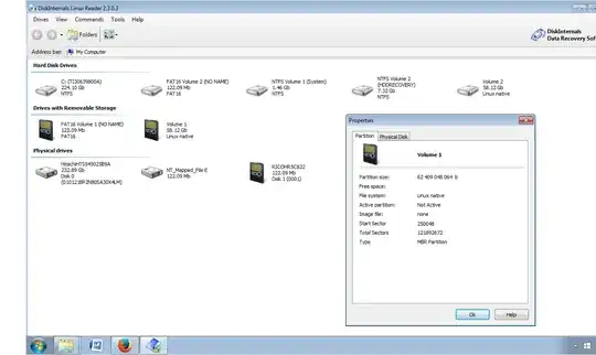

boot. Have you checked Disk Management if it's mounted? Some drives have to be mounted manually for whatever reason. – Aloha Jul 06 '16 at 02:09ua-netinstrequires a single FAT32 partition. This is then overwritten with 2 partitions; a FAT16 and an MBR. I'll update the question with more details. – Lee Jul 06 '16 at 07:58ua-netinstyou are going from an MBR formatted device with one FAT32 partition to one with two partitions, one FAT32 and one ext4. This modifies the MBR, it does not add it, and, again, an MBR is not a partition. It's a 1/2 kB of information at the start of the device. – goldilocks Jul 06 '16 at 08:42ext4partition; by "MBR partition" it presumably means this is on an MBR style device (for consistency, it should say the same thing about about the FAT16 partition). – goldilocks Jul 06 '16 at 09:09start.elf). I'll try to put more about this into an answer. – goldilocks Jul 06 '16 at 09:09
