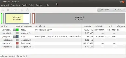

If you are not very comfortable working on the command line, like in Steve Robillards excellent answer, there are some GUI applications available. In particular gparted works very well.
I think it's installed by default on a Ubuntu LiveCD but not on an installed system. There is of course an easy fix for this: apt-get install gparted
. You can't do this on the actual Pi, because to resize partitions they need to be unmounted.

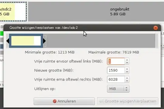

The picture below is in Dutch, but don't let that spoil the fun. It's very easy to use. This is the layout of the default debian image on a 8gb sdcard.
Right-click the partions to unmount them and then right-click to resize or move the partition. You can also create new partitions and format existing ones. In the picture below I've removed the swap partition and now I'm able to resize the root partition to the entire space on the right of it. Don't fill it entirely, because you still have to add a swap partition.
You can play with the partition layout, changes are only written if you apply the changes (the grayed out 'return' key in the first picture).
It's very easy to move partitions but like in Steve's answer I'd recommend you remove the swap partition entirely, then resize the root and then recreate a swap. Moving a partition can take a very long time and the swap does not contain data you need to keep.
