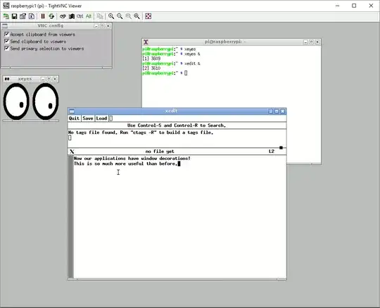

Yes And No
Installing a vnc server will also get you an x server.
(Both the tightvncserver and vnc4server packages provide xserver).
This is enough for you to see and interact with graphical applications.
But you will really, really, really want an x window manager so that you can move the applications around on your screen, resize them, make them stop covering each other, switch between them, etc.
apt-cache search x-window-manager will return a large list of options.
Without a window manager: Without a Window Manager
With a window manager: With a Window Manager

  3. Run vncserver:
    pi@raspberrypi:~ $ vncserver
    You will require a password to access your desktops.
    Password:
    Verify:
    xauth:  file /home/pi/.Xauthority does not exist
    New 'raspberrypi:1 (pi)' desktop is raspberrypi:1
    Creating default startup script /home/pi/.vnc/xstartup
    Starting applications specified in /home/pi/.vnc/xstartup
    Log file is /home/pi/.vnc/raspberrypi:1.log
  4. Connect using a vnc viewer and enjoy!
TightVNC Viewer is one option:
(I picked it because it is FOSS and has an MSI installer).
Remember to do :1!
You'll have to enter the password from earlier:
You will be prompted for the password you set.
