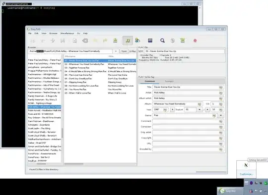

X11 Forwarding
If you just want to use individual graphical applications on your raspberry pi (and not your entire desktop), then you can forward X11 traffic over SSH.
  • On your raspberry pi, edit /etc/ssh/sshd_config and make sure X11Forwarding is set to yes
  • On your laptop, install an X11 server (I use Xming on Windows and XQuartz for Mac)
  • On your laptop, enable X11 Forwarding* and ssh to your raspberry pi
Now, if you try to start a graphical program (say, easytag), it will open a new window on your laptop.
graphical easytag program running on a raspberry pi, but the program window is displayed on the laptop screen
*How to enable X11 Forwarding varies by ssh client program:
  • For the command line ssh, just add -X
  • For PuTTY, check the Enable X11 Forwarding checkbox in Connection > SSH > X11. Also enter 127.0.0.1:0 in the X display location text field.
Troubleshooting
  • If you changed /etc/ssh/sshd_config, reload the ssh daemon using systemctl reload ssh
  • Xming must be installed and running on your laptop in order for X11 Forwarding to function
