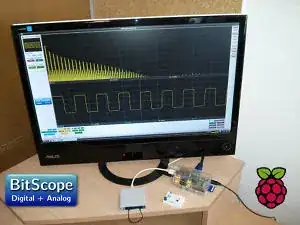

We have found the Raspberry Pi to be an excellent platform for running the software you'd need for a project like this. The problem is getting the signals into the RPi in the first place and performing high speed jitter free real-time signal capture on the same CPU that's running the O/S and application software. Our solution is the BitScope Raspberry Pi Oscilloscope which pairs a BitScope (for high speed mixed signal waveform capture) with the Raspberry Pi which runs all the necessary software.
BitScope
  • 81
  • shameless plug =) – lenik Sep 23 '13 at 23:37
    Thats awesome. But it has nothing to do with the answer! Or maybe it proves that the Pi is to weak to be an oscilloscope? – Piotr Kula Sep 25 '13 at 08:56
  • The Pi is not "too weak" but it does not have the I/O capability needed for (high speed) waveform acquisition. In the words of the original question, it's "under equipped for that" :-) – BitScope Sep 25 '13 at 12:57

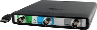

You could connect one of our TiePie engineering Handyscope HS5 oscilloscopes/arbitrary waveform generators to the USB port. A library compiled for the Raspberry Pi to use one or multiple oscilloscopes simultaneously is available for download. The instrument uses its own timing and memory, so there is no performance loss. So yes, the Pi is powerful enough for an oscilloscope project.
Handyscope HS5
Key specifications of the oscilloscope: 2 channels, 14 bit, 500 MS/s, 250 MHz bandwidth, 20 MS/s 14 bit continuous gap free streaming, 32 MS memory per channel, 1 ppm time base accuracy.
Key specifications of the Arbitrary Waveform Generator: 1 µHz to 30 MHz waveforms, 240 MS/s, 14 bit, 64 MS memory, -12 to 12 V output (24 Vpp), 1 ppm time base accuracy.

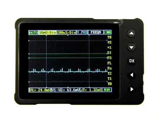

There No need to re invent the wheel here. For example a DSO Nano for under 100USD single channel.
A DSO Nano Quad Channel for under 200USD

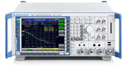

And then, what a Raspberry or similar device CANNOT DO!
And cost a small fortune ...
  • Upto 110Ghz, with hard drive to store data, extremely precise, simulations and triggers.
  • Measures Buuetooth, WCDMA/EDGE/3G/4G, Wireless A/B/G/N 2.4Ghz/5Ghz, SATA, AGP/PCI/PCI-Express, Raw Satellite signals, Hard drive head channels, Ethernet, etc, etc ...
