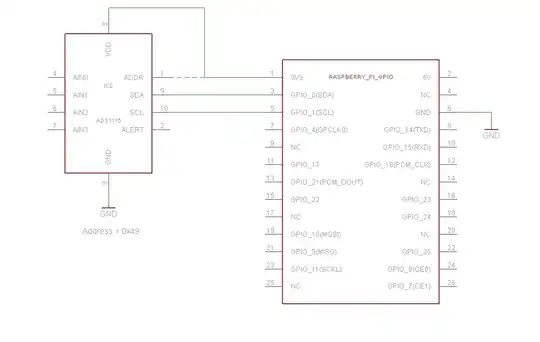

ADS1115
The ADS1113, ADS1114, and ADS1115 are precision analog-to-digital converters (ADCs) with 16 bits of resolution offered in an ultra-small, leadless QFN-10 package or an MSOP-10 package. The ADS1113/4/5 are designed with precision, power, and ease of implementation in mind. The ADS1113/4/5 feature an onboard reference and oscillator. Data are transferred via an I²C-compatible serial interface; four I²C slave addresses can be selected. The ADS1113/4/5 operate from a single power supply ranging from 2.0V to 5.5V.
First you need to make sure the I²C modules are loaded. Next connect the ADS1115 as shown below. There are 4 different addresses possible depending which pin ADDR is connected to. This means you can connect a total of 16 channels to a single I²C bus.
GND=0x48, VDD=0x49, SDA=0x4A, SCL=0X4B
You can see the result of the last conversion like this
# i2cget -y 0 0x49 0 w
0x0000
The default of 0x0000 is returned here since no conversions have been performed yet. Now lets take a look at the config register
# i2cget -y 0 0x49 1 w
0x8385
The LSB is first, so this is equivalent to 0b1000010110000011
I'd like to do a single-ended conversion on AIN0, so I need to write bits[14:12] as 0b100. ie 0b1100010110000011
# i2cset -y 0 0x49 1 0xC385 w
0xa30b
The LSB is first, so this is equal to 2979 decimal

    aren't these package types a little harder to work with because of the pin size/spacing? Especially for those like me with arthritis (which limits my manual dexterity. – Steve Robillard Jul 28 '12 at 21:47
  • @SteveRobillard, yes they are harder to work with, but definitely easier than they appear to be. For MSOP it helps to have magnification, flux, solder wick and a good soldering station. You can have quite a few goes to tack one corner of the MSOP with some solder until you are happy with the positioning. The small size does help to reduce the noise in the circuit so it's worth a try, you may be surprised. – John La Rooy Jul 29 '12 at 07:53
  • Thanks for this, precisely what I was looking for. Haven't done byte order conversion in 25+ years though! Gonna have to shake some rust off. – Saeven Apr 19 '20 at 23:24
  • @JohnLaRooy quick question for you. If I had wanted to do a single ended conversion on A1, Would I have written 0b010, A2, 0b110 and A3 0b001 ? – Saeven Apr 19 '20 at 23:38
    @Saeven, look at "Table 8. Config Register Field Descriptions" in the datasheet. Single ended A1 is 0b101 – John La Rooy Apr 20 '20 at 06:10
    @SteveRobillard, Adafruit has a breakout :) https://www.adafruit.com/product/1085 – John La Rooy Apr 20 '20 at 07:28
  • @JohnLaRooy one last Q for ya. When you got the result from i2cget, would you not move the first bit to the end, and then reverse the string? e.g. a30b, becomes 30ba, becomes ab03?
    (In the same manner that 0x8385 became 3858, and then 8583, which was converted to 0b1000010110000011).
    – Saeven Apr 20 '20 at 19:54
