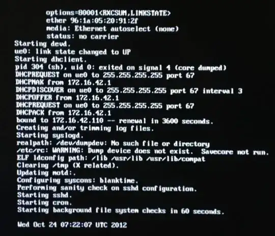

FreeBSD image for Raspberry Pi
Not scared yet? Fine, grab my prebuilt image:
Decompress this and write it to a SD card (at least 1 GB), then plug it in your Raspberry Pi and power it up. The framebuffer works, so after a few seconds you should see boot messages scrolling by and if you have a network cable plugged in you should eventually see a DHCP assigned address.
Now you can ssh in, using login root and password raspberry:
