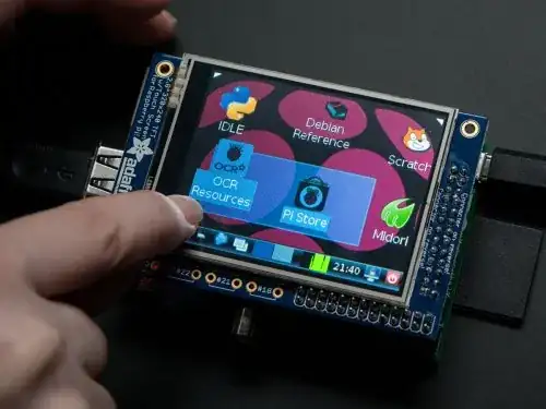

I am creating a home appliance which uses as Raspberry Pi internally to handle the user interface and necessary WiFi connection. Connected to the R-Pi I have an AdaFruit LCD screen:
Adafruit LCD
