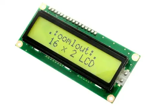

I have a 16x2 KS0066 (apparently compatible with HD44780) LCD screen Picture of LCD screen

  • I bought this before I knew what I was doing: http://www.oomlout.co.uk/lcd-display-16-x-2-p-212.html The technical specifications seem to indicate it will draw 1.2mA@5V. – Mark Ingram Aug 21 '12 at 07:32

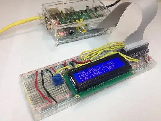

There is a brilliant tutorial at Adafruit how to connect a 16x2 LCD to the Raspberry Pi using the 6 I/O pins.
As this is just a small LCD screen and you said in your comments it only uses 1.2mA you will be perfectly fine to use the +5V GPIO Pin to power the LCD .
