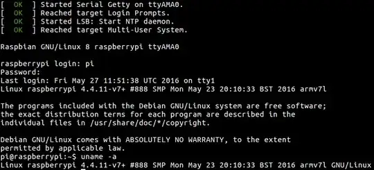

Ubuntu 16.04, QEMU 2.9.0 -M raspi2, Raspbian 2016-05-27, vanilla kernel
  1. Compile QEMU 2.9.0 from source:
    sudo apt-get build-dep qemu-system-arm
    git clone --recursive git://git.qemu-project.org/qemu.git
    cd qemu
    git checkout v2.9.0
    ./configure
    make `nproc`
  2. Download image and extract the kernel and dts from it:
    1. Download the image and unzip it:
      wget http://downloads.raspberrypi.org/raspbian/images/raspbian-2016-05-31/2016-05-27-raspbian-jessie.zip
      unzip 2016-05-27-raspbian-jessie.zip
    2. Mount the second image of the partition. The easiest way is:
      sudo losetup -f --show -P 2016-05-27-raspbian-jessie.img
      This only works with latest losetup on Ubuntu 16.04, other methods at: https://askubuntu.com/questions/69363/mount-single-partition-from-image-of-entire-disk-device/496576#496576
      This prints a loop device, e.g.:
      /dev/loop0
      so we do:
      sudo mkdir /mnt/rpi
      sudo mount /dev/loop0p1 /mnt/rpi
      cp /mnt/rpi/kernel7.img /mnt/rpi/bcm2709-rpi-2-b.dtb .
      sudo umount /mnt/rpi
      sudo losetup -d /dev/loop0
  3. Run:
    ./arm-softmmu/qemu-system-arm \
        -M raspi2 \
        -append "rw earlyprintk loglevel=8 console=ttyAMA0,115200 dwc_otg.lpm_enable=0 root=/dev/mmcblk0p2" \
        -cpu arm1176 \
        -dtb bcm2709-rpi-2-b.dtb \
        -sd 2016-05-27-raspbian-jessie.img \
        -kernel kernel7.img \
        -m 1G \
        -smp 4 \
        -serial stdio \
You can then login on the terminal that shows on your host terminal.

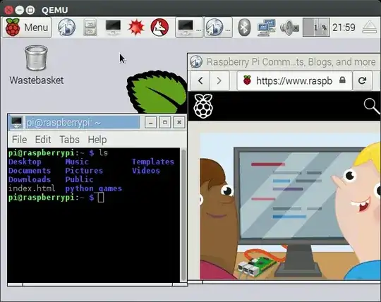

Current limitations:
  • -M raspi2 was added in QEMU 2.6.0, and Ubuntu 16.04 only has QEMU 2.5.0, so we have to compile QEMU from source. But this is not hard.
  • the GUI shows but is not responding to the mouse / keyboard, tested on both SDL and VNC. But CLI works perfectly however. So you might as well use the Lite image which has go GUI for now.

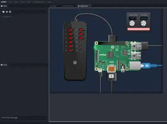

You could easily try a Raspberry Pi simulator included with sensor, command line and file editor at iotify.io. Check out our documentation at https://docs.iotify.io/ to get started with the different projects, OS and make yourself familiar with Raspberry Pi working environment.
