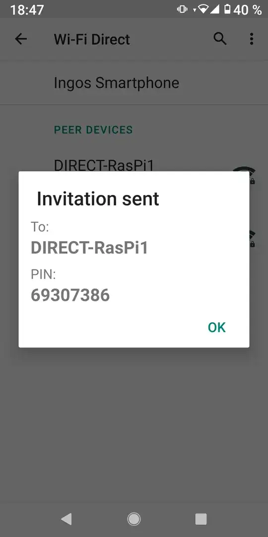

Connect with the pin code method, with pin set by the smartphone
For the completeness I will show also this connection method. If you have checked that the mandatory connection method with pin entry, asked by the phone works, then you can try to use this method with setting the pin.
The problem is that we have to tell the smartphone to use pin auth. But I haven't found a place to set it on the phone. So we must tell it from the RasPi. This is done with the command set config_methods. This configuration is send to the phone when finding is active, so we have to set it before starting p2p_find:
rpi ~$ wpa_cli -i p2p-dev-wlan0 set config_methods virtual_display
rpi ~$ wpa_cli -i p2p-dev-wlan0 p2p_find
Now I go to the WiFi Direct page on my smartphone
Settings -> Network & Internet -> Wi-Fi -> Wi-Fi preferences -> Advanced -> Wi-Fi Direct. Tick the three-point in the upper right corner and select Search for devices if not already Searching... and tick the DIRECT-RasPi1. You are presented a pin:
Now I can look with wpa_cli -i p2p-dev-wlan0 p2p_peers what mac addresses of found devices are available. Then I have to show the details for every mac address with wpa_cli -i p2p-dev-wlan0 p2p_peer <MAC-ADDR> what name it has to find my smartphone. I do it with this one liner, for example:
rpi ~$ for i in $( wpa_cli -i p2p-dev-wlan0 p2p_peers ); do echo -n "$i "; wpa_cli -i p2p-dev-wlan0 p2p_peer $i | grep device_name=; done
86:cf:bf:8e:f1:06 device_name=Ingos Smartphone
32:cd:a7:f2:ee:5c device_name=DIRECT-1KC48x Series
and find 86:cf:bf:8e:f1:06 for Ingos Smartphone. Now I only work with this mac address (p2p_dev_addr) and connect to it. Note that we use the pin presented by the smartphone (here 69307386):
rpi ~$ wpa_cli -i p2p-dev-wlan0 p2p_connect 86:cf:bf:8e:f1:06 69307386
OK
On the smartphone click OK to the Invitation sent and the status will change to Connected:

Basic workflow in fixed password mode (keypad):
- send
set config_methods keypad - send
p2p_find - received events
P2P-PROV-DISC-SHOW-PIN,P2P-GO-NEG-REQUEST,P2P-DEVICE-FOUND` - the client pops up the password message; enter an 8-digit password
- send
p2p_connect <addr> <8-digit password> display - received events P2P-FIND-STOPPED, P2P-GO-NEG-SUCCESS, CTRL-EVENT-SCAN-RESULTS, P2P-GROUP-FORMATION-SUCCESS, P2P-GROUP-STARTED (followed by the group name, which is useful to be registered in order to allow deleting it on client disconnection), AP-STA-CONNECTED. The client sets the “connected” state after receiving an IP address.
- if the client disconnects, the AP-STA-DISCONNECTED event is received. Alternatively, the group can be removed in order to produce the disconnection of the client.
- upon AP-STA-DISCONNECTED event, it is useful to send
p2p_group_remove <group>so that a new group can be created. Then, send againp2p_findto announce again the server to the network.
If p2p_connect fails, first check the existence of EBUSY errors 16 in journalctl, meaning that a group or an AP had already been allocated; then verify that the client accepted the request.
To start a Wi-Fi Direct connection with Android and connect a Raspberry Pi AP, tap Settings > Wi-Fi > Advanced settings > Wi-Fi Direct and wait for the Raspberry Pi peer device to appear.
