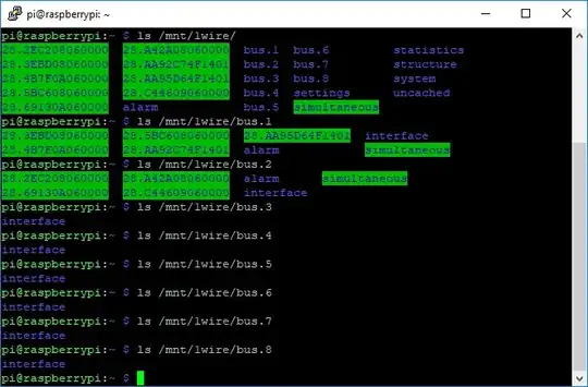

Configuring python owfs (Refs 29, 32)
Part 2 - Testing OWFS Server without any DS18B20 sensor connected.
Part 3 - Detecting One DS18B20 Temperature Sensor

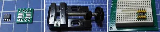

Part 4 - Soldering second DS2482-100 chip to breakout board for testing.
Soldering the chip to the breakout board took me 7 minutes.  The pins are 0.05" apart. So it is not that difficult to complete the soldering task.  My trick is the following: (1) Separately tin only one pin and one pad, (2) Put the chip on top of breakout board and use the soldering tip to melt the only one pin to pad, with a couple of trial and errors to precisely position the chip.  The duPoint male connector pin soldering job are easy.  Final multi-meter open short testing is also straighforward.
Part 5 Testing two DS2482 and twoDS18B20 sensors
