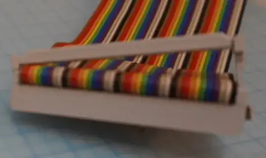

Suggestion 12 - Hacking a ribbon cable update 2020jan14hkt1936
(1) Aligning and Crimping Ribbon Connectors
(2) Custom Cables & Guide to Crimping Dupont PCB Interconnect Cables
