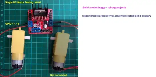

Try my L298N python program for your buggy! :)
# Driving One Motor Using GpioZeo and L298N v0.01  tlfong01  2019jun11hkt1156
# rpi3B+ python 3.5.3 gpiozero 1.5.0 L298N
# wiring -
from time import sleep
from gpiozero import Motor
motor = Motor(17, 18)
motor.forward()
sleep(2)
motor.backward()
sleep(2)
motor.reverse
sleep(2)
motor.stop()

  • disregard my last comment, I miscounted GPIO ports before XD but everything is working now, thanks! – thecanmanisback Jun 11 '19 at 13:30
  • How nice to hear the good news! – tlfong01 Jun 11 '19 at 13:47
