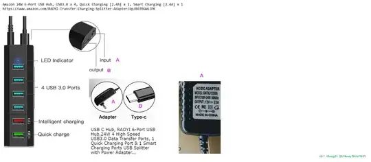

  • i might have to add more details to my question as i see you must off misunderstood what im asking or using, why would you suggest to plug the RPI's to the hub if you just stated that i cannot exceed ~5.5V ? i already said that my power hub is 12V. – Arlet Paz May 29 '19 at 16:42
  • What I mean is: the HUBs output voltage is 5V (otherwise it wasn't compatible with USB) and its input voltage is 12V. You should verify this with a multimeter before plugging the Pis in! – Sim Son May 29 '19 at 16:46
  • no the hub is not 5V where are you getting this from i took a picture so everyone can see and it clearly says 12V 2A – Arlet Paz May 29 '19 at 16:51
  • Thank you for the pictures They are useful. ALL USB hubs output (or provide) +5 volts, to do otherwise would not be normal. Your hub is powered by a 12 volt power supply, that is fine. But ALL USB hubs output 5 volts. The Hub converts the 12 volts to 5 volts. All of this being stated, what Sim Son stated is correct, if the hub is a "normal" USB hub it will probably not be able to power even one RPi, or at least not reliably... – Wendall May 29 '19 at 17:04

  • okay okay thanks now we're talking. So i do own a MM and i ran a test and see that what Wandall mentioned is true and confirms Sim Son post as well, this is converting or stepping down the Voltage across its ports so i did see 5V respectfully on all ports and i did a current test which kinda got me worry as it displays 2.8A on all ports so i guess my new question is "would this blow my Pi's" since RPI take 2.5A – Arlet Paz May 29 '19 at 17:37
  • Now that you know it has 5V everything is fine. The PIs will not blow up as they won't sink 2.8A (take a look at Ohm's law). How exactly did you measure the current?! If you short the ports they are the ones that might blow up :/ – Sim Son May 29 '19 at 17:45

Power 2 Rsp3b+ via a Power USB hub [powered by 12VDC 2A, 24W wall wart]
Will blow or burn Pi's due to over voltage?
Answer
Well it is 90% likely (but no guarantee!) that everything should go well, if you use the "[2.4A] Intelligent charging" and "[2.4A] Quick charging" ports, one for each Rpi.
six port usb hub
Amazon 24W 6-Port USB Hub, USB3.0 x 4, Quick Charging [2.4A] x 1, Smart Charging [2.4A] x 1
