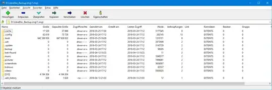

I made an IMG-File of my LibreELEC and now i want to edit it on my Windows machine.
I need to make changes in the /etc-Folder and I can't do that live on the system since LibreELEC is read-only FS.
So I opened the img-File with 7-zip and there is no /etc-Folder. It seems as this is the /storage-Folder!
7zip
Any suggestions where I can find and edit the /etc-Folder?
  • Hello, can you add to some details on how you created your IMG file to your question? From your screenshot it looks like you're in some sort of nested archive rather than an actual disk image (LibreELEC_Backup.img\1.img). Is there a LibreELEC_Backup.img\0.img or ..\2.img that might be other partitions of the disk? – Roger Jones May 22 '19 at 15:33
  • Well there is 1.img but this is the boot partition and there is 3 - without any file Extension, maybe it is the swap file – Michael Gierer May 24 '19 at 04:45

  • Well, i took the image via Win32DiskImager. But the statement you gave about destroying the /etc folder is not true, since LibreElec uses a Read-only system and you cannot alter anything under these folders, also not with root! – Michael Gierer May 24 '19 at 04:44
  • @MichaelGierer You are right. I haven't realized that there is running a compressed read only squashfs filesystem. I have updated my answer. – Ingo May 24 '19 at 10:17
