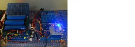

Appendix B - My GPS module setup
GPS module setup

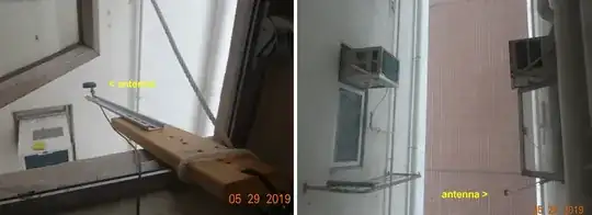

Appendix C - My GPS Antenna setup
GPS Antenna setup
Fix times 2019may23hkt2100 - first fix = 8 minutes, followed by 14 sec, 24 sec, 25 sec, 1.24 min, 1.13 min, then 17 min no fix, end of fixing test.

Appendix E - GPS Fix Time Measurement with Antenna 1 metre out of window
I surprising found that even with the antenna just 1 meter out of the window, the fix time is regularly less than 1 minute. My quick and dirty conclusion is that it not necessary at all to try any fix at the rooftop garden, ... :)

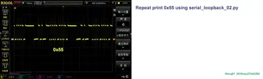

Appendix L - Testing Rpi built in UART serial loopback and repeat send char
The repeat send char 0x55 TxD waveform
rpi serial repeat send char 0x55

def testSerialPortLoopBack(serialPort, writeBytes, maxBytesLength, waitSeconds):
    print('        Begin serialPortLoopBack() [Remember to connect Tx to Rx!] , ...')
    serialPortWriteWaitReadBytes(serialPort, writeBytes, maxBytesLength, waitSeconds)
    print('        End   serialPortLoopBack(), ...')
    return

#Test serial port repeat write bytes ***
#testSerailPortRepeatWriteBytes(serialPort = serialPort0, writeBytes = b'0x55', \
#                               betweenBytePauseSeconds = 0.005, repeatCount = 200000000)
# Test serial loop back ***
testSerialPortLoopBack(serialPort = serialPort0, writeBytes = b'AT\r\n', maxBytesLength = 32, waitSeconds = 0.01)

Appendix P - GPS/BD Antenna positioning and 15 metre RS232 cable testing
I found that it is not necessary to place the antenna to far out of the window, 15 cm can already get a good fix. So it is laughable that earlier I prepared a 3 meter long rod in order to position the antenna as far as possible from the window, because I read so many experience users and experts saying that PSU must be very very stable, must open sky etc etc. All the info I read does not apply at my geographical position and GPS module. I guess I need to check out a not GPS/BD, but GPS only, perhaps Neo-xM module to compare and contrast, to see if I still can get a good fix.
fix test 15 cm
