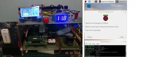

Two identical Rpi3B+ setups, "good" setup boots SD Card OK. The "bad" setup can only start booting to 4 green LED blinks, then stops.
Why?
Answer
I suspected your PSU is marginal, and when booting, drops to a low voltage much below 5V, and so any weird thing can happen.
So I tried using a adjustable PSU and see if Rpi can boot at a voltage as low as 4V. My PSU is has a huge 10,000 uF (yes, 10,000 uF!) bypass capacitor, so there should be almost no glitches or blinking when booting. I also checked with my 3.5 digit DVM to make sure the voltage very near Rpi micro USD connector is almost the same as the PSU.
I surprising found that Rpi3B+ can boot a stretch 9.8 SD card at 4V (I think there should every little chance that your official PSU blinks below 3V3), though with yellow lightning warning and text message saying low voltage etc.
My conclusion is that my guess was wrong. Even if your PSU drops to as low as 4V, Rpi's on board LDO regulator can very forgivingly accept and boots to the end with the welcome screen!
Any brain storming suggestions welcome.
