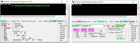

Update 2019may17hkt1628
In case loopback /dev/serial0 works but /dev/ttyACM0 does not work, then it might be the external USB problem. I usually recommend to use the powerful RealTerm to do troubleshooting. You might might read the details in the second reference below. RealTerm can send/receive long strings of file, store data in files, new line setting, etc. So it is much faster than python and the not so powerful puTTY or TeraTerm. I show below a couple of screen captures for your reference. You might also like to read SparkFun for their recommendation of RealTerm (see reference below). And in case you are trying USB/TTL cables, good quality USB cable is also important. I usually recommend CH340 drivers, though Raspbian accepts PX2xxx drivers OK.

  • Lots to look into here! Thank you! The modem is directly connected into the pi, no cable. I'll try to use some of your suggested tools and read your links today. I will have to play more with it after work. I appreciate the information! – Shrout1 May 17 '19 at 11:29
  • @Shrout1 You are welcome. I suggest to also try USB/TTL cable, for easy swap testing, and also sooner or later you might need more than one UART channel. Good luck and have a nice weekend. – tlfong01 May 17 '19 at 12:10
  • Worked it out! I was trying to poll the TTY too quickly and so I was looking for a response before the modem could actually query the network. Thanks again for your help! – Shrout1 May 17 '19 at 18:24
  • How nice! I also learnt a lesson from your experiments. I am thinking of adding a user programmable delay in my UART loopback program, so the user can adjust the delays. You also remind me when I first played with a BlueTooth serial module. I did not realize in the beginning that the blue tooth modules needs some time (in the order of milliseconds) to process the data from Rpi. And after adding a wait-for-module-operation function, all problems disappeared! Have a nice weekend! – tlfong01 May 18 '19 at 00:57
