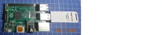

I'm new to Raspberry Pi and trying to connect one to my mobile WiFi rooter. However there's an error that keeps me away from it for 10 hours. Please help me.
Initial Situation
- Wireless & Wired Network Setting says it has "No wireless interfaces found."
- I typed
sudo raspi-config
to change settings of both Wi-fi Country(I4) and WI-fi (N2), which all responded "No wireless interface found" error.
What I tried then
- I tried
ifconfig wlan0 up
, which responded to me such:
wpa_supplicant: /sbin/wpa_supplicant daemon failed to start
run-parts: /etc/network/if-pre-up.d/wpasupplicant exited with return code 1
ifup: failed to bring up wlan0
- I've searched and some said I need changes on
/etc/network/interfaces
and/etc/wpa_supplicant/wpa_supplicant.conf
, I've fixed each of them below:
# /etc/network/interfaces
source-directory /etc/network/interfaces.d
auto lo
iface lo inet loopback
iface eth0 inet manual
allow-hotplug wlan0
iface wlan0 inet manual
wpa-conf /etc/wpa_supplicant/wpa_supplicant.conf
allow-hotplug wlan1
iface wlan1 inet manual
# /etc/wpa_supplicant/wpa_supplicant.conf
ctrl_interface=DIR=/var/run/wpa_supplicant GROUP=netdev
update_config=1
network={
ssid="(my rooter's SSID here)"
psk="(Its password here)"
# (After these changes I've executed 'sudo reboot' already.)```
- As I'm unable to connect it to the Wi-Fi, I cannot execute
sudo apt-get update
like some recommended.
I'm totally at a loss how to fix this. Please give me an advice.
