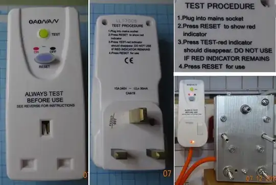

And to play safe, you can use electricity leakage protect circuit breaking plugs.
