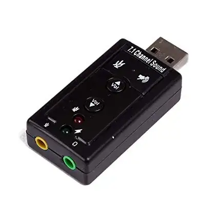

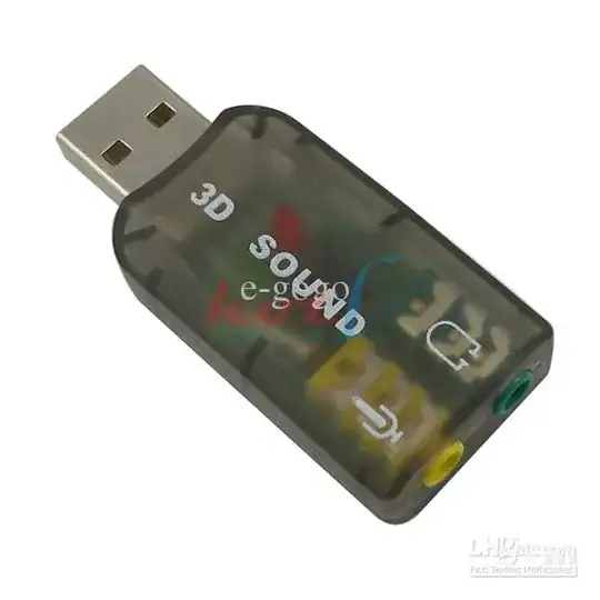

Pictures of my two sound cards:
USB sound card#1
USB sound card#2

Try recording on a PC - if you have the same noise while recording, then the issue is with a faulty soundcard and not with the Pi. Considering the looks of that device, I wouldn't be surprised if it wasn't working properly.

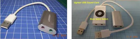

Ah, that is usually called positive audio feedback oscillation, or Larsen Effect.
  1. Install latest driver.
  2. Try another USB sound card. Don't use cheapy or fancy cards like 3D, 7.1. I recommend just simple mono or stereo.
Positive audio feedback usually centres around the high frequency end. If you don't need very HiFi, you can get a sound card such a uGreen which enables you to select low frequency mode, that can reduce positive feedback triggering.
And when recording, try place microphone and speaker further apart, not facing each other, rearranging long cable, use shielded/grounded wires, turn down volume etc etc to change the physical positive feedback path.
If you are recording in a small room, or a narrow partition, it sometimes helps to place soft cloth curtains around you, or face loudspeaker towards an open window. The main idea is to change the main sound reflection path and phase angle, thus reduce the chance of triggering oscillation, ...
ugreen sound card
