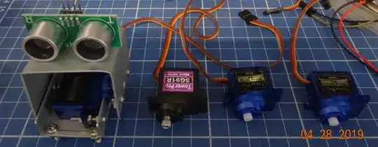

Can you show me a zoom in view of your completed job?

I am day dreaming of assembling a Google like self driving toy car. I have DIYed a tilting platform holding the ultrasonic sensor, controlled by one servo, and the platform controlled by another stepping motor or servo, which should turn 360 degrees, ...

  • That is really cool by the way, what sensor is that on the left? – Snuffles Apr 28 '19 at 08:38
  • I think 50 means duty cycle, but I am not very sure. And the "sensor on the left" is my high class ultrasonic sensor, costing me 5 yuan. Last time I thought I should respect you more because you are building a intelligent magic cube project. But now you appear not to know much about PWM and ultrasonic sensor, so now I should respect you less. Anyway it balances out. I need to read the tutorial first before I can talk to you again. I am going to gym and eat again. Have a nice day. See you tomorrow or day after tomorrow. – tlfong01 Apr 28 '19 at 09:03
