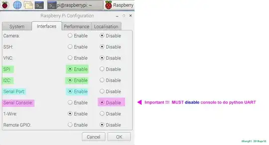

One thing I usually remind python UART newbies is to disable serial console, see picture below.
disable console
