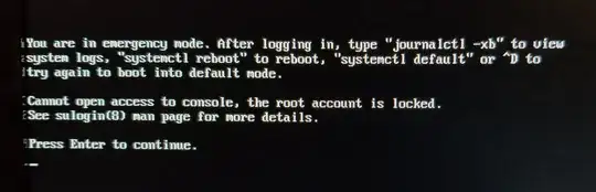

Issue:
- messed up /etc/fstab
- bootfail
- my PI is , as many, not hooked up to a screen or keyboard, running somewhere doing its job.
