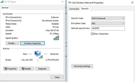

can't establish connection wia WIFI. Can't understant what I'm doing wrong:
there is connection properties from my windows PC enter image description here

  • just a wild idea... The SSID "TP-Link" is rather generic. Could it be that there is another AP with that name around? If yes, please check the BSSID. – oh.dae.su Feb 16 '19 at 18:40
  • no, I live in private house – degr Feb 16 '19 at 18:49
