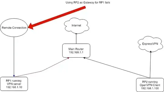

RP1 - connects to my home network using Softether (For remote access) RP2 - connects to an external VPN (ExpressVPN) diagram

  • I do not understand what you mean. Can you please provide a diagram of your network setup? What is Softether and a virtualdhcp? – Ingo Feb 12 '19 at 14:58
  • I don’t have s diagram but both raspberry pi’s connect to my main router 192.168.1.1, when I use the IP address of the vpn gateway running openvpn it works on all devices except when I connect remotely to another raspberry pi using vpn. If i stop openvpn i can connect remotely. – MTSOP Feb 12 '19 at 15:03
  • I've thought you just paint a picture on a sheet of paper, take a photo of it and link to the photo in your question. Or you may use drawing software. Do you have two openvpn tunnel, one outgoing with one RasPi and one incomming with a second RasPi? – Ingo Feb 12 '19 at 15:14
  • I added an image, the outgoing vpn is OpenVPN, the incoming one uses SoftEther using this guide: https://curlybrac.es/2016/11/22/set-up-vpn-server-on-raspberry-pi/ – MTSOP Feb 12 '19 at 15:32
  • +1 That makes everything clear. But before spending effort to the answer I would ask if you could also accept a different solution using systemd-networkd? I think here are to much different components that must fit together and dhcpcd is not the best solution for sophisticated configurations. I only had a glance at Softether: tldr. I just assume it's a remote VPN server that we can connect to as openVPN client. – Ingo Feb 12 '19 at 20:28
  • I could look at a solution based on these experiences: Cannot connect to PiVPN Server from WAN but can connect through LAN, Raspberry pi as access point with vpn, Routing issue - use vpn gateway router and others. I'm hopeful that we can reduce complexity by using only one RasPi as VPN gateway. – Ingo Feb 12 '19 at 20:29

  • Both have an internet connection from my internet router, 1 connects to ExpressVPN and 1 accepts VPN connections. If i use the local IP addresss for the RP that connects to ExpressVPN as a gateway, it will work but cannot VPN to that box anymore.

  • No, both (RP1, RP2) are clients on the local network 192.168.1.0/24 and this way they can get into the internet. Only the Main Router has an internet connection. It is important to see it this way, otherwise you cannot understand the routing issues. If you shut down the Main Router, both cannot get into the internet like any other client on the LAN. – Ingo Feb 13 '19 at 11:25
  • Correct. When I try to connect to the 2nd RP it doesnt work because something with the routing is not working, thats what im trying to achieve. Use the gateway of the RP1 while i am on the RP2 vpn – MTSOP Feb 13 '19 at 11:30

  • 192.168.21.231 is RP I can vpn into, 192.168.21.232 is the RP i connect to Expressvpn, 192.168.21.1 is the main router. – MTSOP Feb 13 '19 at 12:10
  • OK and that is the Home network? But in your drawing all devices have 192.168.1.* ip addresses. – Ingo Feb 13 '19 at 12:18
  • Yes the diagram IPs are not the same just for demonstration – MTSOP Feb 13 '19 at 12:41
