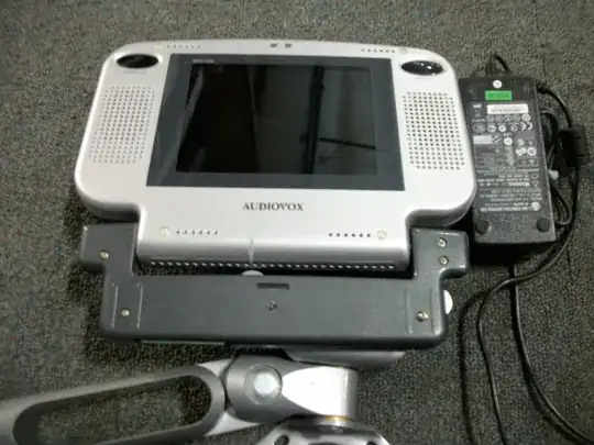

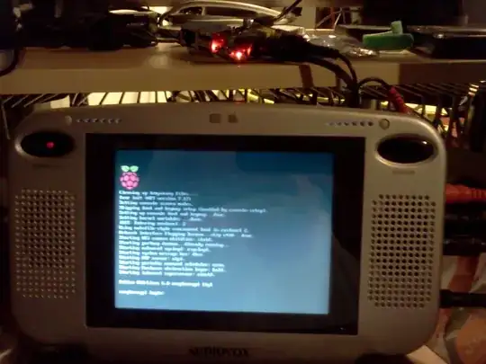

If price didn't matter to me, I probably would have purchased one of the Lilliput monitors, but price does matter to me, so I didn't. I ended up deciding on a DVD "second screen" that had an included mount and AC adapter on eBay. second screen Sound inputs are included, and it has AC power. I don't plan on my usage requiring anything too fancy in the resolution department, and I was looking for the most cost-effective way to get my Raspberry Pi running. Getting it from ebay meant that I paid a pittance ($20), but I had to lurk around a lot of different auctions to find it at that price, since they're usually closer to $50. This also means that I don't have a warranty and I'm purchasing a product more or less sight unseen, so I may not have the image quality that I was originally hoping for. In my case, it worked fine when I hooked it up, as evidenced below: running the Pi

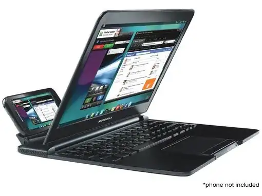

You can purchase a lapdock, made for a cell phone, that will provide you a portable keyboard and monitor for use with your RPI. Simply connect an HDMI to HDMI micro female adapter to the lapdock.
They are often on sale for ~$60. Likely far cheaper than any other monitor you will find. and it's designed to be portable.
http://slickdeals.net/f/4346796-Newegg-59-99-FS-AT-T-Motorola-11-6-Lapdock-for-AT-T-Motorola-ATRIX-4G-w-1GB-RAM-1GHz-Dual-Core-Processor-Firefox-Browser
Here's a website that gives you a full rundown on how to accomplish this. http://rpidock.blogspot.com/2012/05/raspberry-pi-and-motorola-lapdock.html
Here is where you can purchase the cable needed for hdmi specifically. http://www.ebay.com/itm/280761232832?ssPageName=STRK:MEWNX:IT&_trksid=p3984.m1497.l2649#ht_2827wt_1163
