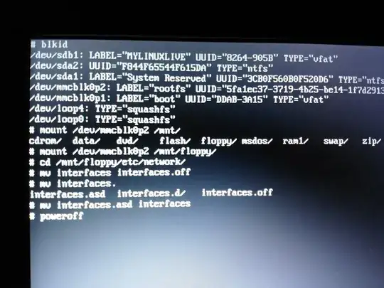

As @Dougie recommended, i was using Live linux to roll back the /etc/network/interfaces file on the Pi's SD:
  1. because i had no USB stick, or not even a CD/CD-rom I was using an USB SD reader and old 2Gb SD card
  2. with the amazing LinuxLive USB Creator and
  3. PuppyLinux: Tahrpup 6.0 CE
  4. using the following commands:
    • blkid - command-line utility to locate/print block device attributes
    • mount - mount a filesystem
And my Pi is up and running! :-)
