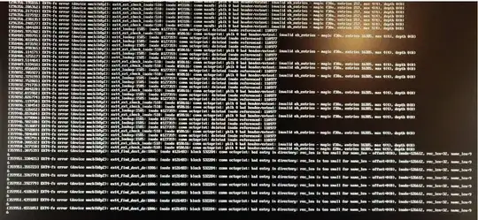

Update
Got a new error. I turned off the printer and left the rPi on over the weekend and came back to discover the uploaded image. Because I didn't really see an option, I did a power cycle which resulted in a boot loop and I'm now re-flashing yet again. This is getting to be a little annoying.

The problem certainly looks like it is SD card corruption, which can happen as a result of arbitrarily cycling the power.
It shouldn't happen during normal operation. Reboots should be obvious in the system logs, OctoPi is Raspbian based, so you could start with /var/log/syslog (you can also use journalctl).
If you can observe with a monitor that it happens exactly when you turn off the printer, it would decisively confirm whether or not that is the cause. If it is, the Pi and software are not to blame. Which is sort of unfortunate, because it means there is nothing you can do about it other than try another 3D printer...
